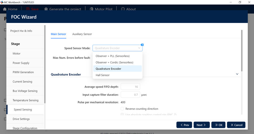

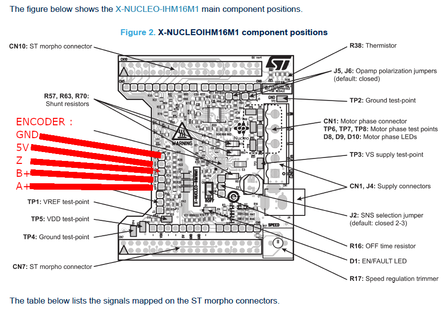

You will find attached a few pictures that (I hope) will help you understand a bit better how to enable the encoder via Workbench, and how to plug the encoder to the right pins of the IHM16 powerboard. The two last screenshots come from the IHM16 User Manual that can be found here pages 5 and 9.
How to enable Encoder mode via Workbench. Current sensing does not need to be changed.
The location of the 5 pins used for Encoder (and Hall Sensors) on IHM16M1.

Thanks for these pictures! I have it exactly like that, so the issues might lay here: Either my motor parameters are not good enough or the encoder parameters are wrong or both. I guess I have to keep trying...
