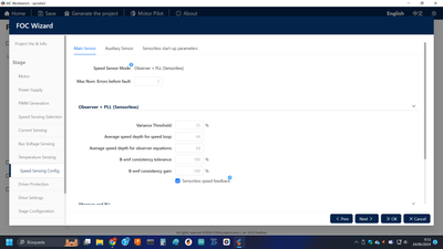

The motor is configured with the main Observer+PLL sensor. Without enabling the hall sensor or the encoder.
The program does not work. It is disconnected from the communications port.
