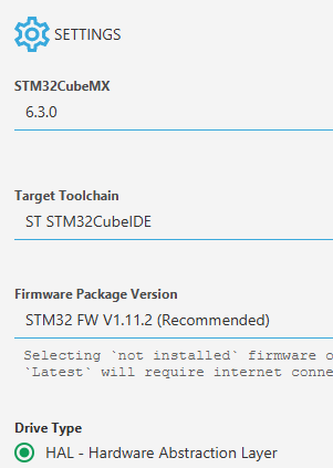

I use MotorControl Workbench 5.Y.2., STM32CubeIDE 1.8.0, STM32CubeMX 6.3.0.
At least this version configuration allows me to upload the project into the board.
I am loading the example 6S_STEVAL3202_SL_VM.
Saving it in separate location.
The only changes I do:
Unchecking Hall Sensors and Encoder in motor section and select Sensor-less (Observer+PLL) in Speed sensing.
I click " Project Generation:I click "Update"

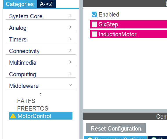

Instead, I click It opens STM32CubeMX, where I can find some yellow triangles, magenta lines and all green ticks on a "System View".
I am leaving everything intact, including:
I am clicking
It generates the code and kindly allows me to "Open Project" that brings me to STM32CubeIDE 1.8.0.

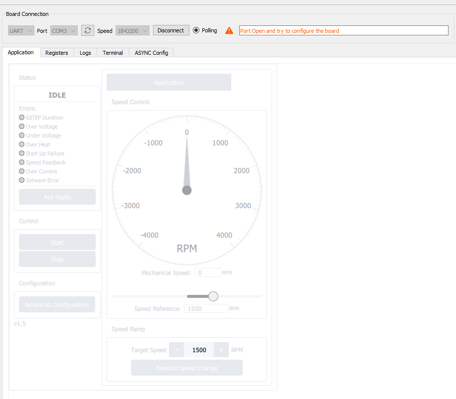

Launching the Motor Pilot. Connecting to the board. It sort of connects:
GUI is inactive and I am getting this nonstop:
I feel I am as far from running the motor as I was a week ago.

Why I cannot connect via UART with both examples loaded, at any baudrate, including 9600?

Hi, I have exactly the same issue and behavior as you described.
I tried all baudrates (including changing them in ST Motor Controller Workbench -> Digital I/O block), and probed UART line with oscilloscope on the J7 of the STEVAL-SPIN3201: I see that ST Motor Pilot sends some data from PC, but the board never replies.
Apparently the support for this board didn't age well. Were you able to make it work from your side?
Thanks.
2022-07-28 7:37 AM
For the record, I was able to make it connect using version 5.4.8 of Motor Control Workbench of (the oldest one available for download as of today) with STM32CubeMX v6.6.1 and STM32CubeIDE v1.10.1.
Still, it's not very stable: it works best on 9600, often takes multiple attempts to connect and disconnects often.
