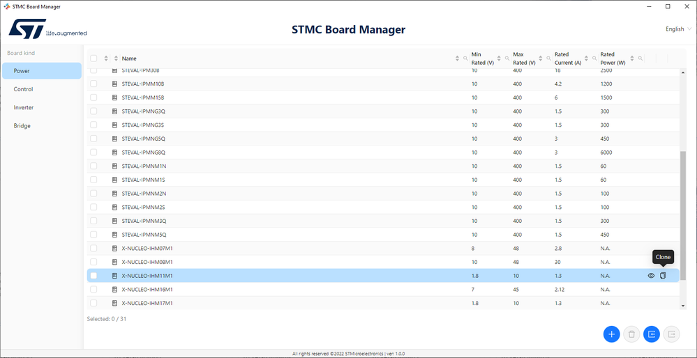

The recommended way to create your own board is to clone one ST board, and to modify it.
I attach a screen shot of the board manager highlighting the "clone" icon dedicated to this purpose.
If you start your design from a topology you evaluated from an ST board, modifying the board according to you own design should be straightforward.
Do not hesitate to share what is your starting point and what do you want to modify. It will also help us provide documentation at the right level of expectation.
