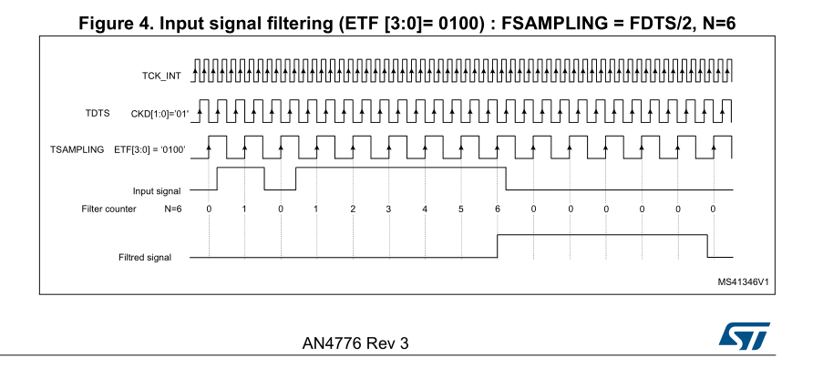

I fail to see how this works as a filter.
The following figure from AN4776 illustrates how the input capture filter rejects short pulses (i.e. noise):
It's not a perfect solution, of course. It introduces delay, and it's aimed at removing random switching noise not periodic interference (in which case it may produce confusing results).

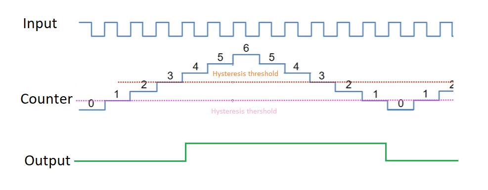

2022-03-01 2:33 PM
Hi everybody,
I think I don't understand what you're saying.
When I implement a low pass filter with a counter, I put two hysteresis thresholds.
Here's a rapid drawing about the relationship between the input, the counter and the output.
2022-04-26 11:32 AM
The AN4776 had the details needed.
