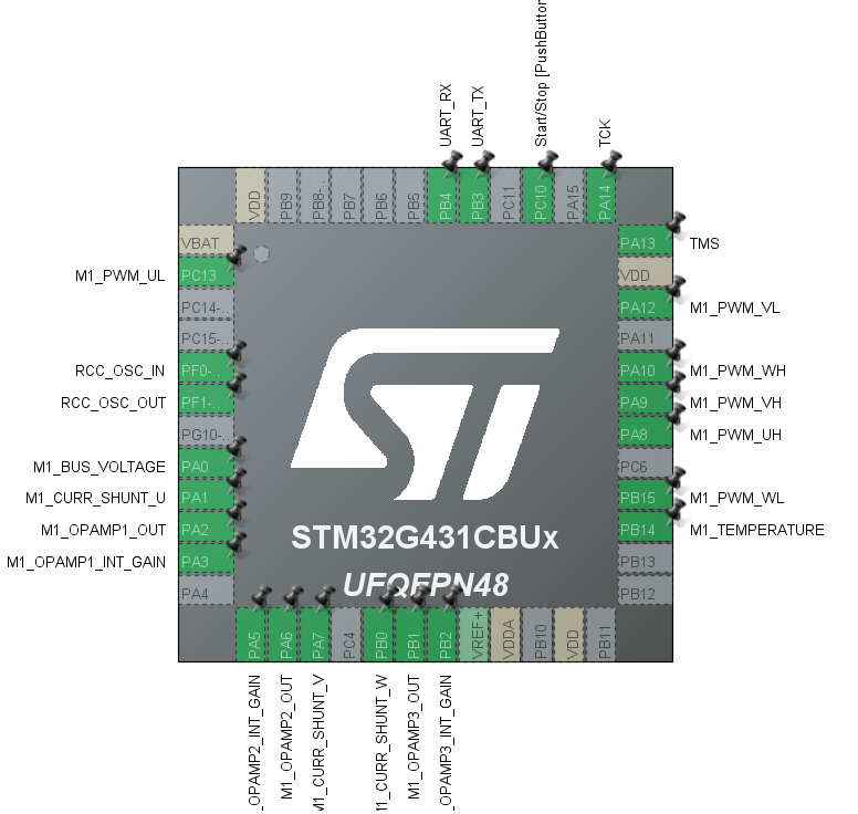

I have done the configuration of the B-G431B-ESC1 step by step with MC Workbench.
In the end I was able to control the motor with Motor Pilot.

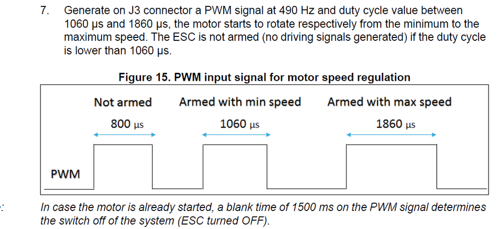

In the next step, I wanted to control the speed with an external PWM as described in the data sheet of the B-G431B-ESC1, but it wouldn't work.
I checked the pin configuration and found that the PWM pin is not defined.
Could you help me to control the motor via the PWM input on J3.
Many thanks and kind regards
Lorenz
1 REPLY 1
adoug.11
Associate II
Yeah I have the same problem. It appears to be a mistake in the examples.
