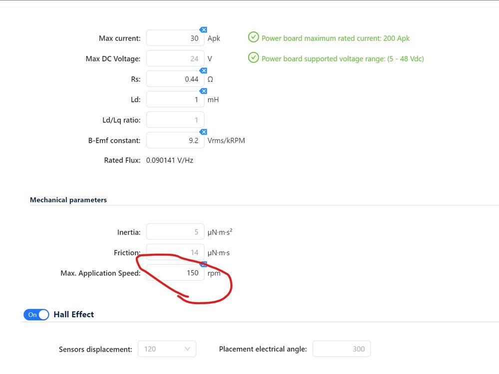

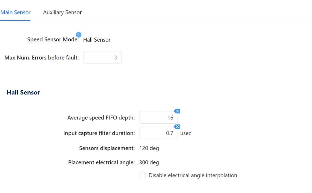

Hi, I'm working on a project in MC Workbench 6.3.2 and trying to configure a motor with a maximum speed of 150 RPM. When I set the "Max. Application Speed" parameter to 150 RPM (as shown in the first picture), I encounter an error related to the "Speed Sensing Configuration". I've attempted various parameter combinations for the Hall Sensor settings (as shown in the second picture), but haven't resolved the issue. Could you please advise on how to fix this problem? Thank you for your help.

Hello @DF_MC ,
What is the issue you encountered related to the "Speed Sensing Configuration"?
Few remarks, your board is design to handle 200 A, and your motor max current is 30A.
Be aware that your board is perhaps oversized making it not accurate enough to properly read the current especially if your motor spin slowly.
Second point, I see that your Hall sensors config is the default. Do not forget to configure it according to your motor characteristics.

2025-06-29 7:38 PM
Thank you for your reply! I believe I can generate the code for my board with the current settings, but I’d like to better understand the relationship between the maximum application speed and the Hall sensor configurations.

If you designed your own board, starting from a ST board, it should be straightforward to describe it with the board designer tool by cloning the ST board. Most of the parameters that are board dependent are not configurable with the workbench, that's why I think it is better (and cleaner) to describe your board. It will also ease the reuse of your board.
To answer your question, there is no relationship between the maximum application speed and the hall sensor configurations.
