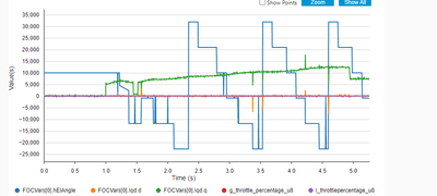

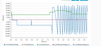

2023-10-10 2:57 AM - edited 2023-10-10 3:20 AM
With the update of this code i do not get the Hall error but the start up is not smooth, it takes time before it starts and goes to normal speed in the vehicle in the loading conditions.
I really need some solution for this. The vehicle goes in kinds of steps before it picks up.
2023-10-10 5:39 AM - edited 2023-10-10 5:39 AM
After flashing this software i am also seeing some kind of distortion in waveform in between or small kind of jerks

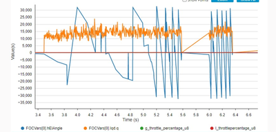

2023-10-20 5:03 AM
This issue keeps happening where the vehicle goes in steps and jerks observed before it smoothens. Any support on this please.
