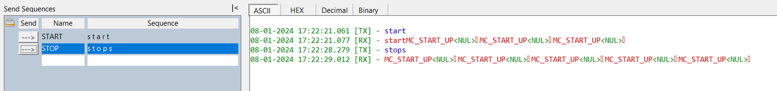

Below i provided output screen:
can anyone with any suggestion or any input why i am getting this error?

2024-01-08 10:25 PM
hi @cedric H
I am using STM32G474RE board, uisng motor control workbench 6.1.2 and I have checked motor with motor profiler.
I want to know that why i am getting this fault errors.
Also can you tell me how to resolve this error
