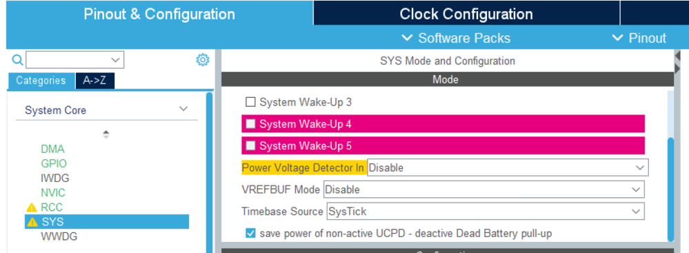

Hi @Shane Kent,
Thank you for reporting this issue in the code generation process.
To overcome this limitation you may follow these steps:
Let me know if these info help you to solve your issue.
