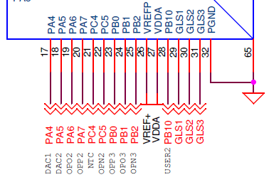

I use the EVSPIN32G4 eval board to control the motor with an analog voltage through the PA4 pin, corresponding to ADC2 channel 17. Despite enabling ADC2 IN17 in CubeMX, the generated code does not include initialization for ADC2 channel 17.

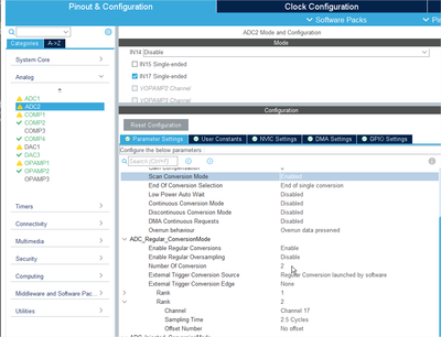

I generated an EVSPIN32G4 from scratch with MCSDK6.3, opening .ioc file with CubeMx, I went to ADC2 Tab, select "IN17 Single-ended", go to "ADC2 parameter settings", add this new conversion on ADC_Regular_ConversionMode field for example, and generated code with CubeMx. On main.c file, I have the ADC2 IN17 initialization...

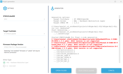

However, I do not see a configuration for ADC2 channel 17 within that initialization. Like below
/** Configure Regular Channel
sConfig.Channel = ADC_CHANNEL_5;
sConfig.Rank = ADC_REGULAR_RANK_1;
sConfig.SamplingTime = ADC_SAMPLETIME_47CYCLES_5;
sConfig.SingleDiff = ADC_SINGLE_ENDED;
sConfig.OffsetNumber = ADC_OFFSET_NONE;
sConfig.Offset = 0;
if (HAL_ADC_ConfigChannel(&hadc2, &sConfig) != HAL_OK)
Error_Handler();
The Motor Control Workbench project was developed using STM32CubeMX version 6.9.2 and MCSDK version 6.2.0. However, attempting to migrate to MCSDK version 6.3.0 results in encountered errors.
attr not supported : dmpu
I have reverted to the original version developed with MCSDK 6.2.0 and STM32CubeMX 6.9.2. However, I am now facing errors with this version as well.

Did you add ADC2 IN17 conversion as below? And generating project with CubeMx, did a warning message is displayed?
