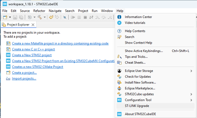

With STM32CubeIDE tool, you can try to upgrade the ST-LINK version:
If you agree with the answer, please accept it by clicking on 'Accept as solution'.
