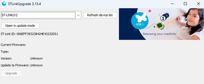

Using STM32CubeIDE 1.18.1, I had a message for updating ST-LINK. After firstly "Refresh device list", and "Open in update mode", I upgraded ST-LINK.
After ST-LINK update, I am able to flash the board and launch the FW with STM32CubeIDE.
