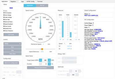

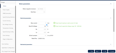

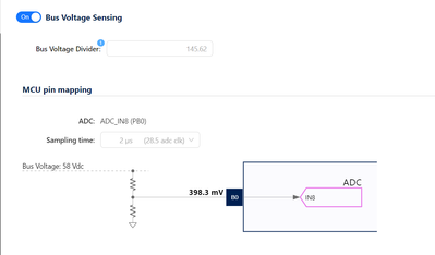

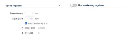

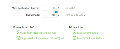

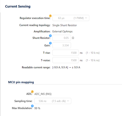

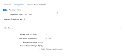

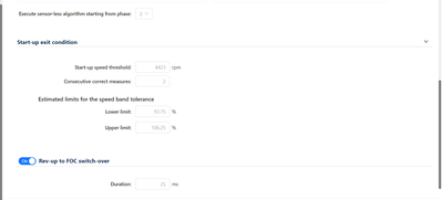

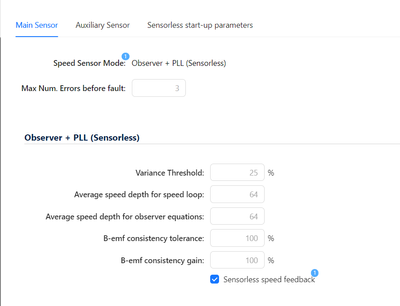

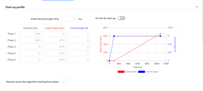

I have purchased EVSPIN32F0602S1 motor control board for controlling my motor. I have tried too many configurations to control the motor but I have failed. My motor specs are 325VDC, 8A BLDC motor. For the tests, I have applied 60VDC voltage to board. In open loop and speed sensing config is Observer+PLL, I have managed to turn the motor for a while, after that it returned me FOC Duration error. Then I selected speed sensing config as HAL Sensor, but no matter which configuration I tried, it didn't work. Here is the figures about my configuration.

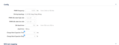

Hi, @GMA
I have reduced pwm frequency to 10KHz, but motor doesn't turn. I am using Motor Pilot app to control board, when I pressed the start button, there is a noise coming from motor, but it doesn't run.
Here is the run state of board.

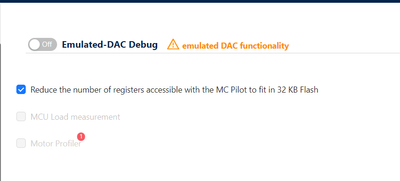

Hi, @GMA
I have tried driving motor with hall sensors, but it made noises and it returned speed feedback error or start-up failure. When I try the Motor Profiller tool, it returns me "Motor profiller not available for MCU". I am totally sure U, V, W wirings are correct. Is there any tutorial or example of using this board to drive BLDC motor with or within HAL Sensor?

Hello @osmantasbasi.,
On your previous attempt, the PWM frequency is still set to 20 kHz (visible on the Motor Pilot interface).
With Observer+PLL on the main sensor and the HALL sensor on the auxiliary, plot the STOPLL_EL_ANGLE and the HALL_EL_ANGLE using the Motor Pilot high-frequency plot. Both signals must be aligned.
Decrease the PWM frequency when the FOC duration is triggered.
