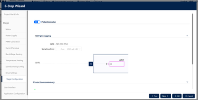

Hi SimpleStep
for using potentiometer, i suggest you first to set the potentiometer feature into the ST MCSDK WB. This will generate all the SW required to control your motor with the potentiometer.
Best regards.
Fabrice

Hi Fabrice,
Thank you for the information, however I am going to be using this in an embedded system and there will be no communication with the controller after the initial program is downloaded.
This is why I sent the 6step_conf.h file hoping changing this would allow me to run it without the use of the 6-step wizard.
I also need to make a connection to the system with a serial port for initial testing. After that it will not be used again expect for possibly debug info.
regards.
