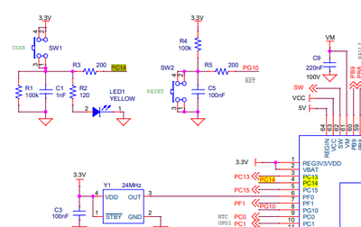

  2. Which GPIO pin controls the user LED (for a blink test)?

2. Which user LED are you referring to? If it is the yellow LED1, note that PC14 is defined as an input for the start/stop button feature.
