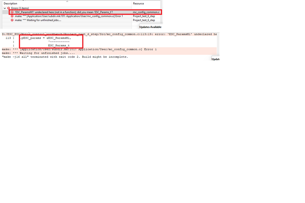

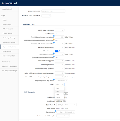

As per your suggestion, we implement 6 step algorithm using MC Workbench 6.3.0. but we are getting the below error, as mentioned in the attached image. we are using B-G431B-ESC1 inverter board from ST Microelectronics.
Hello @Research_Associate,
ESC input uses TIM2. You have to select another timer for the speed sensing config.

GMA
Hello @GMA
We tried your suggestion and used Timer 3, but we are still encountering the same error.
Error Details.
File Name : mc_config_common.c
line number 113.
GMA
Which MCSDK version are you using?
With MCSDK6.3.2, I do not have such error.
