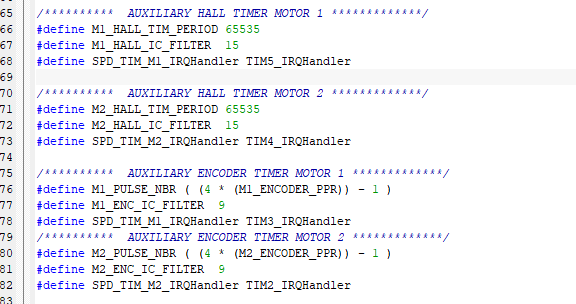

When I use both the Hall sensor and the encoder, the encoder serves as the Main sensor and the Hall sensor as the Auxiliary sensor.The code it generates has a warning:
Warning[Pa181]: incompatible redefinition of macro "SPD_TIM_M1_IRQHandler" (declared at line 268)
It prompted me to define both the Hall sensor and the encoder timer as SPD_TIM_M1/2_IRQHandler.And the notes are all hints as AUXILIARY ** TIMER MOTOR.
When I was debugging, the program got stuck after “HAL_NVIC_EnableIRQ(TIM5_IRQn);�?
It loops around here:
Is my engineering configuration not right or cannot be used in this way,If you encounter this problem, please communicate with me.

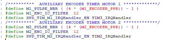

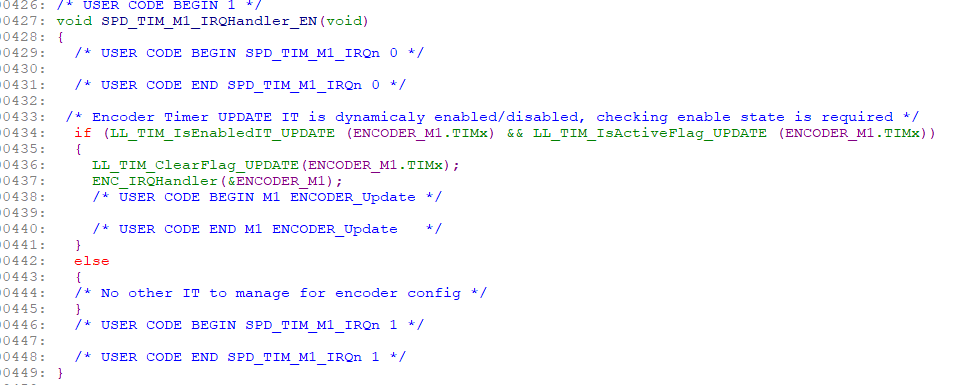

I've solved it.I guess it was a bug generated when generating code.
I added the TIM interrupt used by the encoder.And renamed the macro definition of the encoder capture.And it works.
Change the name of the duplicate macro definition:
Write interrupt functions 1:
Channel two is the same as channel one.
