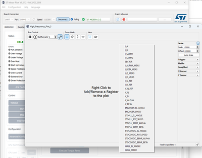

Hello @Danu_Park,
Using Motor Control Pilot tool, "Graph & Record" left button, and select ELectrical ANGLEs to display:
2024-11-14 12:16 AM
Hello @Danu_Park,
Could you verify motor connect connection: U, V and W phases and Encoder signal?
Did you try using Sensor Less as Main speed sensing and Encoder as Auxiliary to check that both reported electrical angles are aligned?

Hello @Danu_Park,

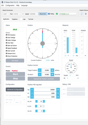

Hello @Danu_Park,
Using Motor Control Pilot "Advanced Configuration", you can tune the position control PID regulator:
