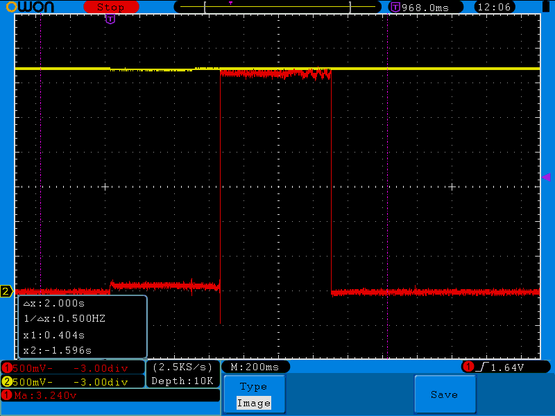

I have a similar problem with the Nucleo IHM07M1. Every time I hit 1.1A it shuts down. Trying to figure out why. I even commented out
void TIMx_BRK_M1_IRQHandler(void)
/* USER CODE BEGIN TIMx_BRK_M1_IRQn 0 */
/* USER CODE END TIMx_BRK_M1_IRQn 0 */
if (LL_TIM_IsActiveFlag_BRK(TIM1))
LL_TIM_ClearFlag_BRK(TIM1);
R3_1_BRK_IRQHandler(&PWM_Handle_M1);
if (LL_TIM_IsActiveFlag_BRK2(TIM1))
LL_TIM_ClearFlag_BRK2(TIM1);
// R3_1_BRK2_IRQHandler(&PWM_Handle_M1);
/* Systick is not executed due low priority so is necessary to call MC_Scheduler here.*/
MC_Scheduler();
/* USER CODE BEGIN TIMx_BRK_M1_IRQn 1 */
/* USER CODE END TIMx_BRK_M1_IRQn 1 */
}in the stm32f30x_mc_it.c to prevent it from "flagging over current" and didn't help, everything stops and the speed reference just drifts off into space due to start up and then faults. I'm suspecting the L6230PD it doing it with its CP+/- inputs however, I don't see anything on the my M1_OPC pin. So I can't understand what's causing this interrupt to trigger and these flags set.
Also looking at the PWM output it won't get past the initial startup profile. which is the default from the nucleo demo.
/****************************** START-UP PARAMETERS **********************/
/* Phase 1 */
#define PHASE1_DURATION 1000 /*milliseconds */
#define PHASE1_FINAL_SPEED_UNIT (0*SPEED_UNIT/U_RPM)
#define PHASE1_FINAL_CURRENT 12032
/* Phase 2 */
#define PHASE2_DURATION 3333 /*milliseconds */
#define PHASE2_FINAL_SPEED_UNIT (3333*SPEED_UNIT/U_RPM)
#define PHASE2_FINAL_CURRENT 12032
/* Phase 3 */
#define PHASE3_DURATION 0 /*milliseconds */
#define PHASE3_FINAL_SPEED_UNIT (3333*SPEED_UNIT/U_RPM)
#define PHASE3_FINAL_CURRENT 12032
/* Phase 4 */
#define PHASE4_DURATION 0 /*milliseconds */
#define PHASE4_FINAL_SPEED_UNIT (3333*SPEED_UNIT/U_RPM)
#define PHASE4_FINAL_CURRENT 12032
/* Phase 5 */
#define PHASE5_DURATION 0 /* milliseconds */
#define PHASE5_FINAL_SPEED_UNIT (3333*SPEED_UNIT/U_RPM)
#define PHASE5_FINAL_CURRENT 12032I captured both one of the PWM Channels [red] and my output compare [yellow] (M1_OPC) which should be what's triggering BRK/2.
Really hope someone has fixed this problem, So far i'm out of ideas to check. I'm going to keep digging. I guess it could be hardware issues?
Edit: One thing to note, the profiler works just fine. it takes a few tries to spin it up but it goes.
Edit 2: Got it working! It was all about the startup / motor parameters. I used the motor profiler and got the correct values and startup, works great! Always profile your motor first! hah.
