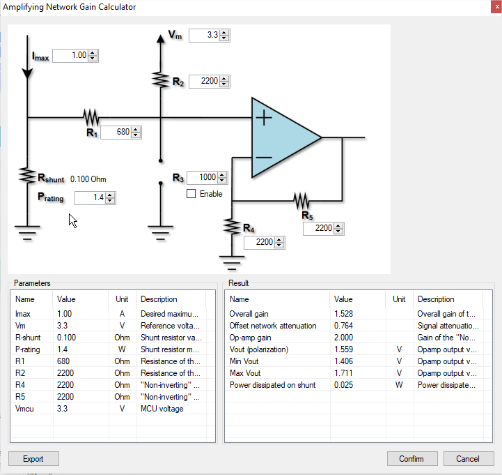

Do my values of 1.53 amplifier gain and 10A measurement range seem correct for that board?
I think upping the amplifier gain would be best solution here.
2022-02-22 5:30 AM
If you open a ST Motor Control workbench and go to "current sensing" box, set "Shunt resistor value" and click on "Calculate". Modifying current or Rshunt value, it computes directly the output dynamic (Min Vout / Max Vout). If you can change physically the Rshunt, you can verify the resulting dynamic.

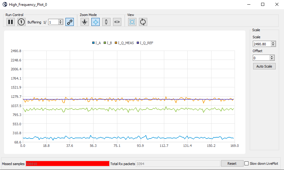

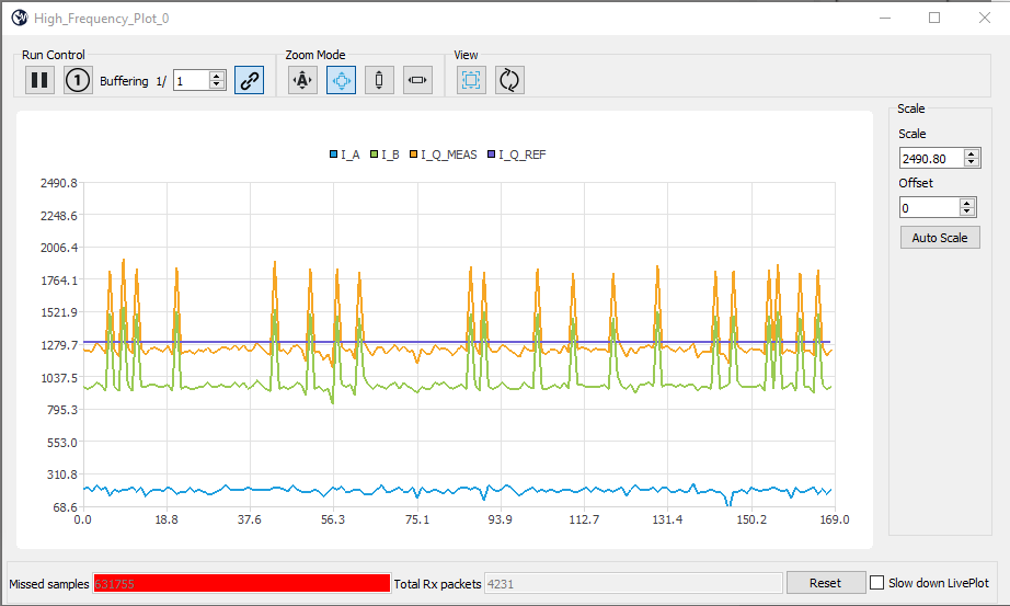

Doing some more digging I think something else is going on with the current. I currently have the motor fixed so it does not rotate. If I run it in torque control mode and slowly ramp up the torque demand you can see the measure current increasing as you expect. It has some noise on it but not too bad (1st image). However, once you reach a certain point it get huge amounts of noise on it, as in the second image.the I_A current is just about straight off the ADC I think. However this looks like a measurement error rather than what is really going on in the hardware. Any ideas what this could be?
2022-02-22 2:55 PM
Just a further note, I am running this in 3 shunt mode. This issue seems to relate to current sampling when as the PWM pulse on time becomes very long as measured on the IN1,2 3 inputs on the power board. I'm guessing the current is measured in the off time and something is going wrong as this period becomes very narrow. Again I'm not sure what influence tRise is having here as all the references to it in the documentation are related to the single shunt operation.
2022-02-23 1:37 AM
You can check "Current sampling in three-shunt topology using two A/D converters" chapter on "STM32 motor control SDK5.x Firmware" document.
Timing parameters parameters as Trise ensure that you are sampling during stabilized current position. Did you verify the Min Dead Time value?
