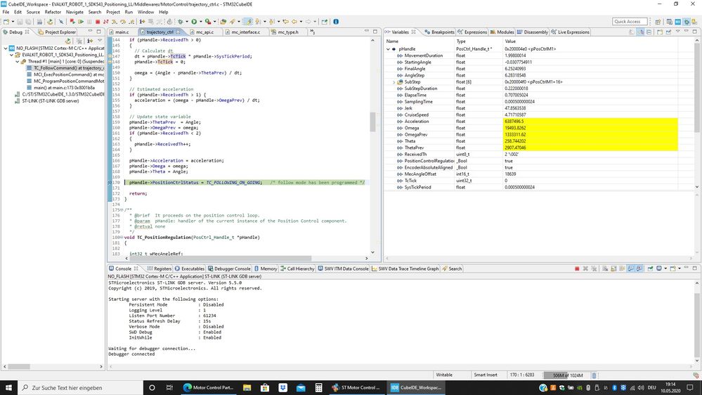

I´ll try to do my best xD Ok, 1st the promised screenshot, while debugging and searching...
As you can see, it stopped at breakpoint in line 170 of trajectory_ctrl.c. In lines 160 and 167, the struct members Omega and OmegaPrev are equally set to the value of the previous calculated (and never altered afterwards) omega variable and therefore should be equal. Also Theta and ThetaPrev in lines 159 and 168 ... Theroretically set to the given function parameter "Angle", which also isn´t altered inside the function. Of course the calculation of "omega" and "acceleration" in lines 150 and 155 rely on ThetaPrev and OmegaPrev ...
Problem here: As far, as i understand the reading of the pHandle struct at the moment, the program stopped, something definitely has happened to the members, while execution.
Correct me, if i´m wrong, but my 1st thoughts went to some other functions, which are able to alter these values, when they are called within an interrupt somewhere between setting them originally and the stop at the breakpoint. It´s very suspicious, that this doesn´t happen all the time. It needs some luck to "catch" that.
At the moment, i took the screenshot, all the original files have been on their original state (exept a) main.c, where i set the target angle and call MC_ProgramPositionCommandMotor1 for the movement and HAL_Delay(1) afterwards , b) the three altered files from the original bugreport) The routines in main are:

HAL_Delay(1);And here the problems "began" xD :
As i understand from documentation, this should work. But anyway the motor did not really move like expected. Of course it was following the given position... Just the movement was very "rough" and even worse:
When it ran for a while (like in the video from the post above, just with faster rpm), at the end (motorposition 44800 on that touchscreen, i use to produce the stepsignals) it should stop for a moment (there´s also a deceleration ramp in the generated step signals) and then move on. At low rpm, this works nice (exept the "roughness"), but at high rpm, at this moment, MC_GetOccurredFaultsMotor1 didn´t return 0 anymore and the motor was switched off...
After playing with PID settings, i quickly found, that these settings didn´t work, like expected ... And of course, i took a look into pid_regulator.c also... Well... Let´s say, i have been "a little bit shocked ;) ", when i saw, how you handle the Kd-Parameter:

2020-05-12 2:00 PM
Hi again @Community member ,
Just took a quick look after your explanation about TC_FollowCommand (the disassembly of the given "way to move" into "steps per tick". I couldn´t debug that so far, but as i complained about that "senseless" pHandle->ReceivedTh, just a few "quick thoughts" about that. I´m not an engineer, but maybe (just maybe ;) ) i found the "original plan behind it". For a moment just forget about the misleading name "ReceivedTh" and the fact, it´s a uint8_t, which can´t hold large values in the following snippet. As i said: Not tested, built or debugged. It´s just to show my idea, how this stuff at least could make sense ;)

2020-05-13 8:13 AM
Dear @Karl Hönemann
Let me explain the reason of the code starting from the original version
Let's take the function TC_FollowCommand. This function is intended to be used in this way: the user at fixed time send the target angle executing a strategy of acceleration/deceleration that is not know by the FW. This function (TC_FollowCommand) is responsible to understand that strategy and to propose to the position controller PID a set of target angles that tries to inerpolate the angle between the receved angles and that can be several intermediate steps.
Let suppose that the master is sending angles that came out from a constant speed. If this funcion is able to understand what is this speed, to calculate the intermediate angle is simple, you have to increment the angle with a constant value that is proportional with the speed and you have the correct interpolated values.
The problem is that tipically in application that requres positioning there is a lot of change in the speed. Basically to move from one point to another point starting from stand still and finish with stand still is necessary first a phase of acceleration, a middle step of constant speed and a final deceleration up to zero speed.
If this strategy is implemented by the master (who defines the positions) the function TC_FollowCommand must identify, not only a constant speed, but also if there is some acceleration, that means variation of speed.
How the function detects speed or acceleration only from the angle that is passed?
The strategy is this one:
But to do this the functon requires at least two values of angle to estimate the speed and three values of angle to estimate the acceleration.
An for this purpose the famous RecivedTh variable (member of the struc) is used.
Initially is zero that means no angle information has been received -> the function can't estimate nothing
After the first received angle the variable is 0 because it will be incremented at the end of the function -> Angle is used as target but the speed can't be estimated
When recive the second point value is 1 -> we receive two angle from now on is possible to compute the speed but no the Acceleration
Finally when we receive the third point the value is 2 -> From now on is possible to estimate both the speed and the acceleration
For this reason the RecivedTh is no more incremented
Once estimated, speed and acceleration are used to integrate respectively the angle and the speed in TC_FollowExecution
If this is now more clear please review you modifications in this optic.
I agree with you that the case of dt = 0 is not managed and this can generate a "very bad" estimation of speed or acceleration and this can occur if the function TC_FollowCommand is executed before the execution of TC_IncTick. If you call to fast the function TC_FollowCommand this could happen.
The most simple solution to this problem should be to skip the estimation in this case. For instance:
if (dt > 0) {
omega = (Angle - pHandle->ThetaPrev) / dt;
if (dt > 0) {
acceleration = (omega - pHandle->OmegaPrev) / dt;
Because the defualt value of omega and acceleration are both zero. Maybe is also the case to reset the ReceivedTh to zero because the expected sequence of estimation is not occurred.
