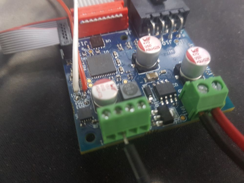

to get reliable (and unaffected) timings and behaviour of the f031, i simply connected step/dir signals to PA15 / PB6 via the provided TP´s. For debugging, i just use the step signals, directly evaluated in TIM2 (external trigger) counter. All the modbus / usart stuff, according timers / interrupts are just disabled. This gives me a "testing environment", where i can be (more or less) sure, if something is wrong, it comes from the mcsdk ;) I attached a picture of the soldering and an "early" video, where partly the dir signal is still active to give you an impression, how it works.
