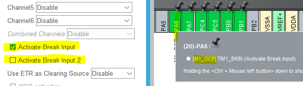

}Also when I check my generated CubeMX project, I see that on the only BKIN input activated is on TIM1, and that BKIN2 is deactivated.
And that in the same file there is the function R3_2_BRK2_IRQHandler() that do set the overcurrent flag.
Aren't the two BKIN inputs/functions swapped ? Can you at ST confirm this is bug ?
