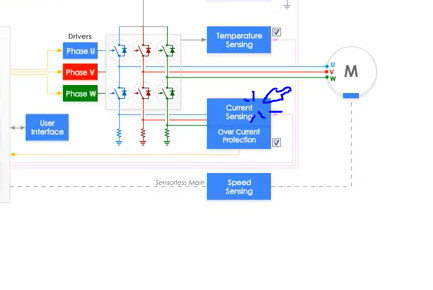

Sensored motor control (current sensing) = there are current sensors (1 2 or even 3) measuring current going trough each phase of the motor, those sensors feed your ADCs.
Sensorless motor control (voltage sensing or sometimes called trapezoidal)= you measure the phase voltage (BEMF) of each phase normally with a opamp , those op amps feed your ADCs.
>,How to do sensorless method in STEVAL SPIN3201 board?
there is an option in ST motor control bench
Click there

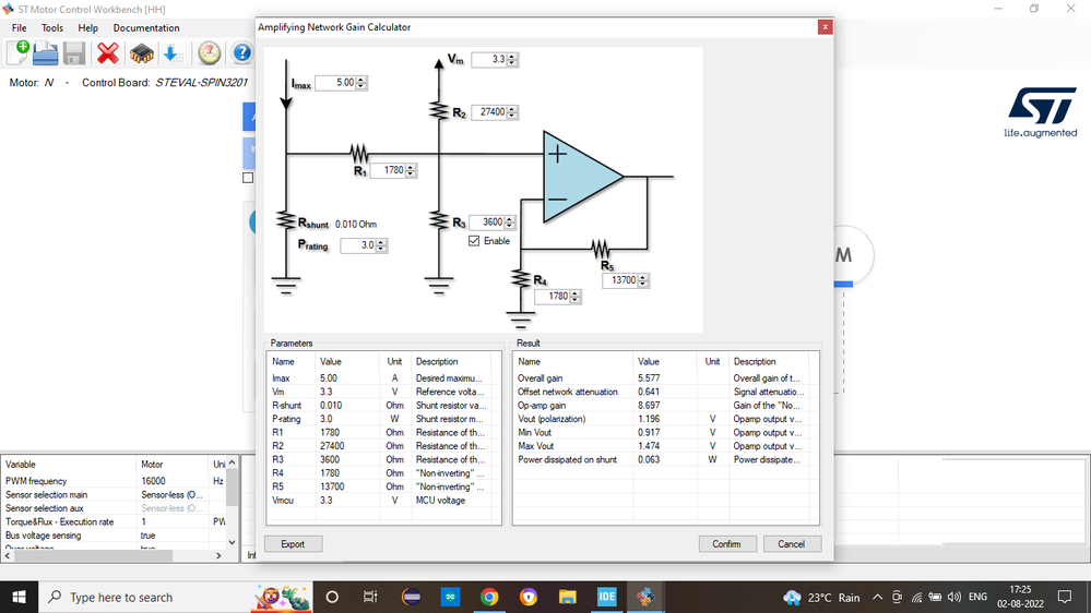

It could also be that you configured the resistances wrong in the DC bus or the measuring resistors values.

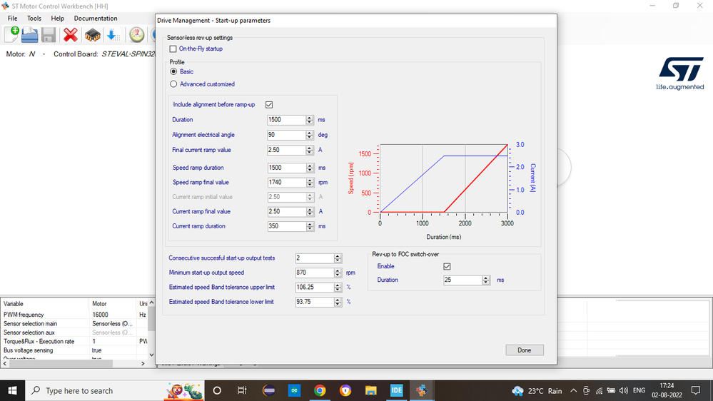

Iam using 60W motor and its nominal current is 6A 15V. With BEMF motor is running and it started to take current ,when its came upto 0.60A suddenly its turning off. Iam doing in STEVALSPIN3201 board .

2022-08-02 4:57 AM
2022-08-02 5:03 AM
