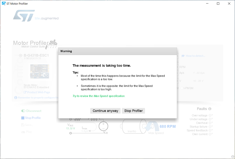

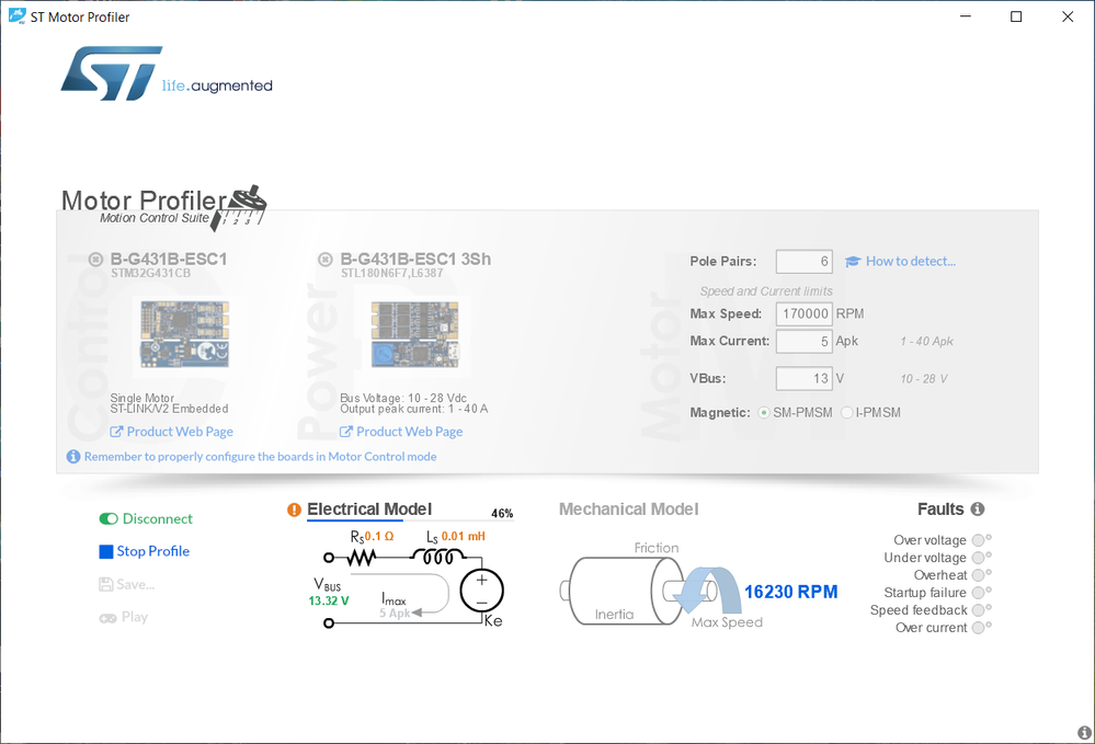

It seems like if I want to run the motor speed to ~17000RPM for example, I have to write 170000RPM instead on the Motor Profiler Version 5.
Also, I kept getting the prompt of the testing takes too long, and it doesn't seem to generate a profile because it's not finished. The profiler doesn't seem to be content regardless of the range of input I set.
FYI : Vsupply = 13V, Current Max = 5A, Max Speed = 17000.
Could you help me figure what might be wrong with it?
