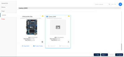

Thanks a bunch for getting back to me!
Guess what? With the updated files you shared, I can now see the STM32C8T6 board right where it belongs, in the Control board section. Big win there!

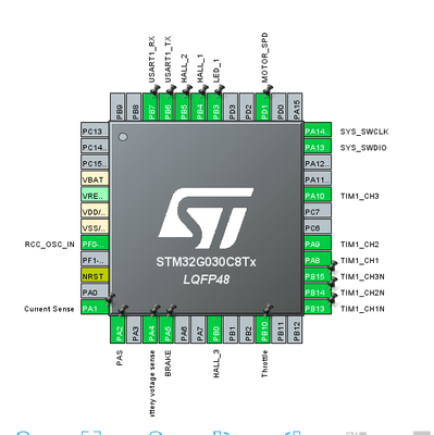

Quick question: I've got this custom-built inverter board with a single shunt current sensing setup, and I've got all the pinouts handy. Do you think it's doable to whip up a custom inverter board JSON file using this info?

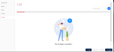

Also, I've noticed something curious. Every time I select this custom board, the bridge tab shows up all empty. Not what I was expecting, to be honest! Any tips on what steps to take next to create a custom board, and why that bridge tab window is staying empty?

Here is the Pinout for microcontroller and custom built hardware
Board is apperaing into workbench
here is the bridge tab
Hello Ethan_hunt04,
Thank you for your feedback, it is always appreciated.
Concerning your inverter board, it is possible to create one using our Board Manager. However you will need to specify in the .json file that it is an inverter board, and not a control board. Thus, you will need only your inverter and no Bridge. If your .json file is described correctly, then the generation should be possible.
