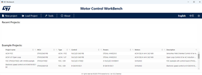

Hello @lamare,
Wiki page isn’t up to date (thank you for the report).
Two ACIM examples are available on the latest X-CUBE-MCSDK-6 workbench available here.
Loading ACIM example of Motor Control workbench, it’s possible to change parameters and generate a project.
