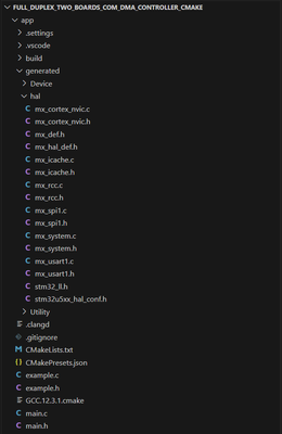

Hello @Harvey White, @chornbeck, @Hamady and @john37
How would I fit with your way of work, if we changed the BSP code with code generated from STM32CubeMX and application code with a clear separation between the two, by having MX generated code in one set of files that the application code calls, in a structure like this?:

2025-09-16 7:39 PM
I'd be concerned that as long as I have to go through and rewrite all the low level calls, that I need to do this only one time and let the driver (or a global) figure out which driver to call.
From what I can see, the only use for a BSP package is to run pre packaged demos that do not (IMHO) contribute to learning much, if anything. The problem is that you do not generate BSP code anywhere. I have to dig the code out of the examples, and IIRC, the examples are not well documented, and are not written to play nice with other code. The HAL2 drivers at least allow you to make a choice between the LL and the HAL level drivers.
Given that choice. I really don't care whether or not when I call a HAL2 driver if it uses LL drivers or higher level HAL2 drivers, as long as it works. If you shifted to BSP drivers, I wouldn't notice as long as they were more or less compatible with the HAL drivers (in terms of function).
I tend to be far more interested in the "get it done" approach to drivers, as long as they do what I need to do. I generally don't care what's under the hood.
My software uses a lot of #ifdef to control operation. Want a serial port, change the #ifdef (uncomment it), and so on. You may consider the same approach.
What I'd like to see, given that you support more than one OS, is a definition that switches that OS in and out as needed.
I do like the idea of a mode on a driver to use DMA or not, IRQ or not, blocking or not, and if an OS is defined, a queue or not. These choices are not useful for all driver situations (SPI, I2C, Serial are all I use), but a good HAL2 driver should address these (and quite frankly, if you use the IOC file, then please put in the callbacks as needed).
