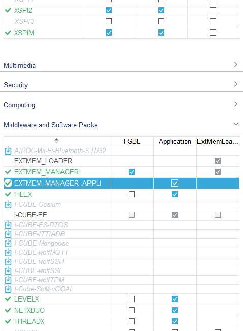

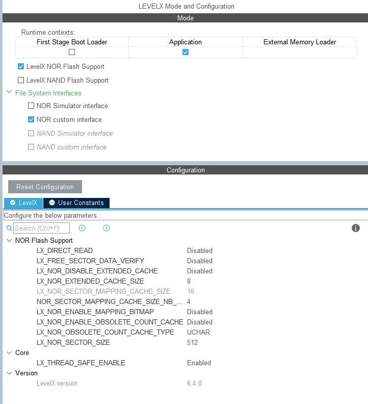

I have a basic FSBL Load and Run application on the NUCLEO-N657 that loads an application from flash into the internal SRAM of the MCU.
Since the N6 has no internal flash, I would like to allocate a portion of the external flash memory to a Fat/FileX volume that the loaded application can use.
What's the preferred method of creating a custom LevelX nor driver in Application for using the OSPI Flash? Should I use the EXTMem manager to abstract the read/writes, or should I integrate the XSPI2 driver directly into the custom LevelX nor controller?

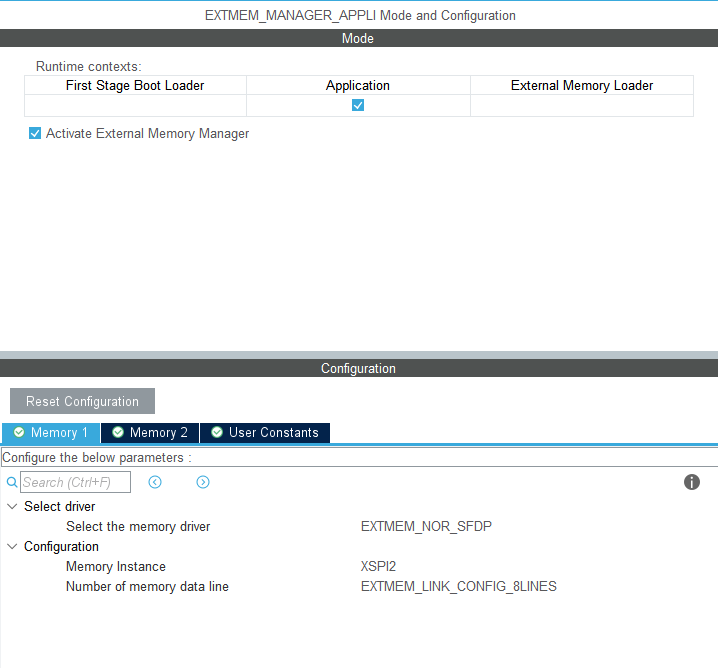

Current Attempt, using EXTMem_manager within custom nor controller:

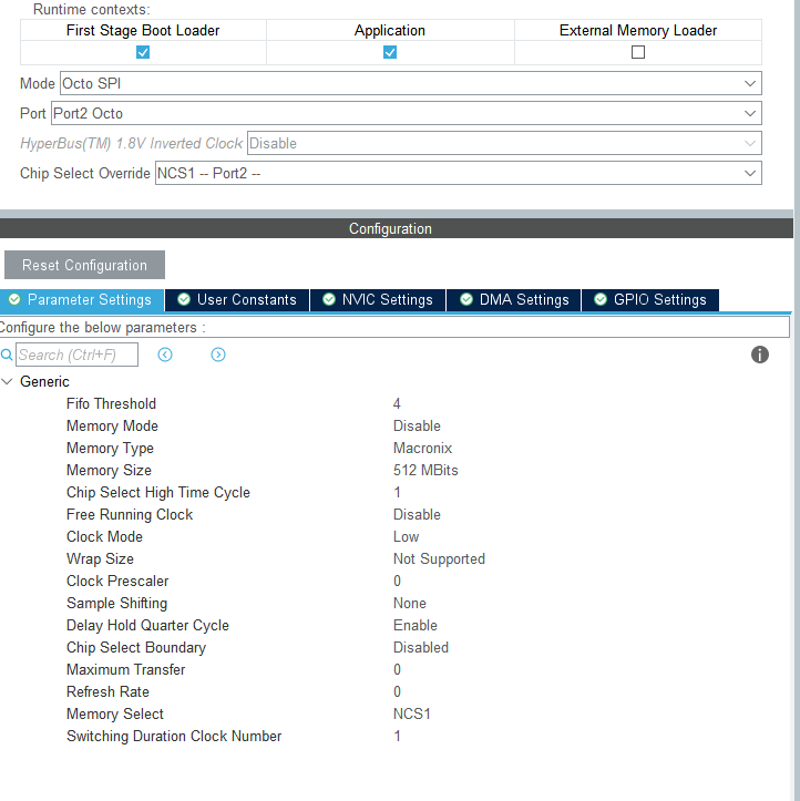

In my FSBL, I successfully init XSPI2, XSPIM, and the EXTMEM_Manager to load and run the application from flash. (Tutorial)
However, once the application begins initialization, the app cannot re-init XSPI2 and times out with a busy error. If I bypass the init of XSPI2, then the EXTMEM manager times out trying to access the XSPI2 peripheral.

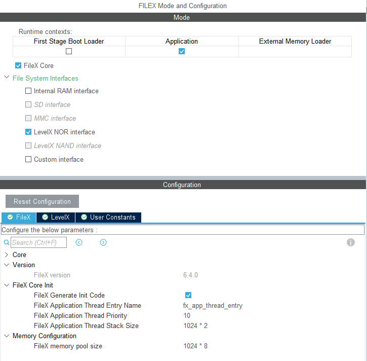

For reference, here's the FileX implementation to load the custom LevelX NOR driver:

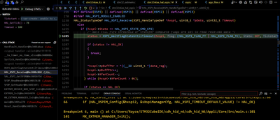

No matter what I try, XSPI2 times out on either infit or in EXTMem_Read in the application.
2025-07-08 12:42 PM
Changing the MX_XSPI2_Init() in the Application to not re-init XSPI2 allows the XSPIM and EXTMEM manager to initialize properly. However, the EXTMEM_Read and Write functions seems to timeout, resulting in

Attempting to DeInit and ReInit XSPI2 in the application causes the EXTMEM_Init to time out on initialization, even though the DeInit/ Init of XSPI2 and XSPIM do not throw any errors.

hxspi2.Init.FifoThresholdByte = 4;
hxspi2.Init.MemoryMode = HAL_XSPI_SINGLE_MEM;
hxspi2.Init.MemoryType = HAL_XSPI_MEMTYPE_MACRONIX;
hxspi2.Init.MemorySize = HAL_XSPI_SIZE_512MB;
hxspi2.Init.ChipSelectHighTimeCycle = 1;
hxspi2.Init.FreeRunningClock = HAL_XSPI_FREERUNCLK_DISABLE;
hxspi2.Init.ClockMode = HAL_XSPI_CLOCK_MODE_0;
hxspi2.Init.WrapSize = HAL_XSPI_WRAP_NOT_SUPPORTED;
hxspi2.Init.ClockPrescaler = 0;
hxspi2.Init.SampleShifting = HAL_XSPI_SAMPLE_SHIFT_NONE;
hxspi2.Init.DelayHoldQuarterCycle = HAL_XSPI_DHQC_ENABLE;
hxspi2.Init.ChipSelectBoundary = HAL_XSPI_BONDARYOF_NONE;
hxspi2.Init.MaxTran = 0;
hxspi2.Init.Refresh = 0;
hxspi2.Init.MemorySelect = HAL_XSPI_CSSEL_NCS1;
HAL_XSPI_DeInit(&hxspi2);
if (HAL_XSPI_Init(&hxspi2) != HAL_OK)
Error_Handler();
sXspiManagerCfg.nCSOverride = HAL_XSPI_CSSEL_OVR_NCS1;
sXspiManagerCfg.IOPort = HAL_XSPIM_IOPORT_2;
sXspiManagerCfg.Req2AckTime = 1;
if (HAL_XSPIM_Config(&hxspi2, &sXspiManagerCfg, HAL_XSPI_TIMEOUT_DEFAULT_VALUE) != HAL_OK)
Error_Handler();
return; // Skip generated code
/* USER CODE END XSPI2_Init 1 */
hxspi2.Instance = XSPI2;
Error_Handler();
Error_Handler();
/* USER CODE BEGIN XSPI2_Init 2 */
/* USER CODE END XSPI2_Init 2 */
}Here's a screen shot of the call stack for where EXTMEM_Init() is hanging, and eventually entering hard fault due to timeout with the above version of XSPI2_Init():
2025-07-10 1:30 AM
Hello @musicmindmachine
It is better to directly use the XSPI2 driver in your custom LevelX NOR controller. You can get inspired from the example below:
