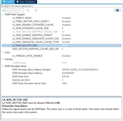

So, you confirm the key is to correctly interpret the block size and total sector count used in USBX match those reported by FileX media (fx_media_bytes_per_sector and fx_media_total_sectors)?
2025-10-16 9:18 AM
Yes theses variables looks right, the mounted device has the right size.
My final NOR chip has a sector size of 4096 bits. So in LevelX I change sector size to 4096 (and increase some buffer, stack and pool size to avoid hard fault)
I'm still with the emulated NOR in RAM.
Everything works well with sector size of 512 or 1024 but since 2048 It does't works.
Windows detect a USB device and ask me to insert a disk in the drive.
With FileX only: I can create a file and read it. I see the file and the texte on my RAM. It seems to have a new block each 0x1000 (=4096) as asked.
With USBX only: windows detect a drive and ask me to format it with 4096o. It works fine and I can create a file with some texte and on RAM I also see block of 0x1000.
It seems that after 1024 bits of sector size, FIlexX ans USBX doesn't works together.
Have you got a idea where is the problem ?
About the sector size, can you confirme I need to set it to 4096 if my NOR has a sector of 4096 bits ?
Thanks in advance for feed back.
Regards,
Dams
2025-10-16 10:43 PM
Hello Dams,
Yes, sector size setting in the LevelX may not be less that physical sector size. Otherwise the system may try to erase a chunk that is less than a physical sector that is impossible. And once again, could you please post you code?
With best regards,
Dmitry

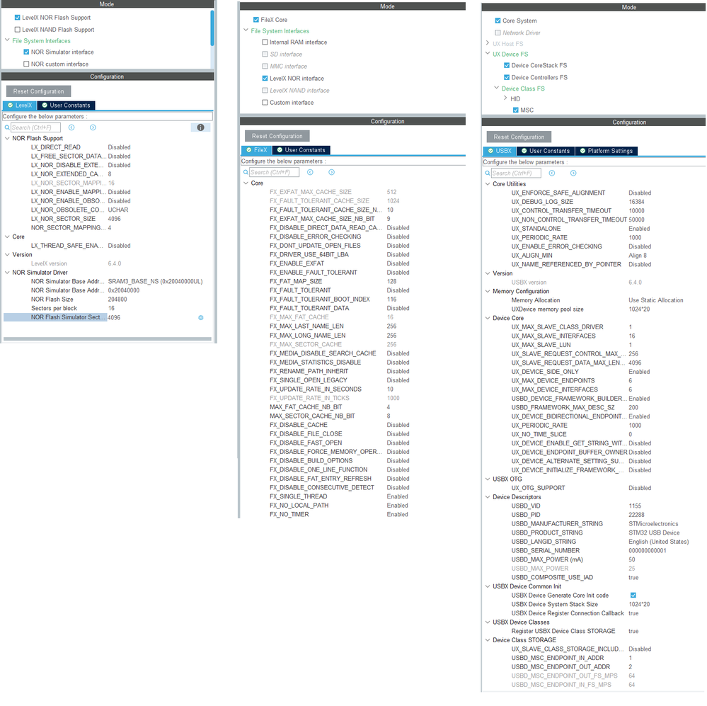

2025-10-17 5:37 AM
Hi Dmitry,
Please find below my code:
main.c:

I'm still stuck on the problem, FileX and USBX works well with simulated NOR of 512 or 1024 bits but it doesn't work with 4096 bits.
With 4096 bits:
- USBX only, windows ask me to format the device and I can create file.
- FileX only: can format, create file, write and read it
I think problem comes from Cube configuration but I don't know where...
Please let me know if you have an idea.
Regards,
Dams
2025-10-17 6:50 AM
Hello Dams,
do you have a mechanism to guarantee that you FX initialization finishes before USBX starts?
With best regards,
Dmitry
2025-10-17 7:03 AM
Hello Dmitry,
Thanks for your response.
In MX_FileX_Init() I use "fx_media_close(&nor_flash_disk)" at the end of the function, before USBX is called.
In USBX I call the "_lx_nor_flash_open(&emulated_nor_flash,name,lx_stm32_nor_simulator_initialize)" when the USB is connected. If the previous session is not closed, the program fail (I test it by connect / disconnect USB cable).
Here the program works only if Sector Size is 512 or 1024..
I take a look to example "Fx_NoR_Write_Read_File" on SMT32U5G9J-DK2 and FileX initialisation seems to be similar.
Regards,
Dams,
2025-10-17 7:14 AM
Hi Dams,
the only thing I can suppose now is that there is a problem in supporting large sector sizes with emulator. If emulator works fine with 512 sector size than I think you may try start working with the real flash.
With best regards,
Dmitry
