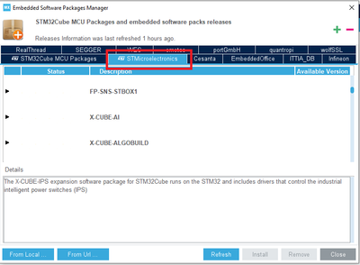

Hello @JavierRomann and welcome to the community,
How did you load that package to "CubeIDE"?
It's not available in the list of CubeMx: Software Packs / Manage Software Packs / STMicroelectronics:

2024-12-02 2:48 AM - edited 2024-12-02 2:56 AM
I don't think this is possible as CubeMx doesn't list it. Meanwhile, I will escalate your request for conformation.
