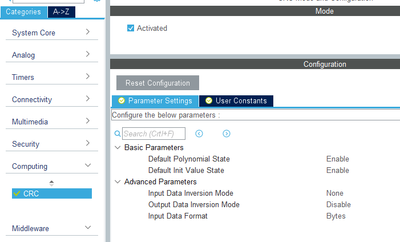

Is the CRC Peripheral clock enabled?
2024-04-11 4:41 AM
Do you mean that with CRC Peripheral clock?
With STM32CubeIDE 1.13.1 it doesn't matter whether this is activated or not. The correct hash always comes out.

ST frequently ties their software to STM32 hardware via test patterns it queries against the CRC unit.

as mentioned by tesla you need to make sure that the CRC is activated you can also deactivate the FPU implementation and select a pure software implementation for the cryptolib.

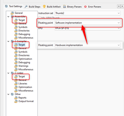

2024-07-04 4:28 AM - edited 2024-07-04 5:29 AM
thanks for the answers.
I tried again to implement an ECDSA calculation in Atollic TrueSTUDIO 9.3. To do this, I first implemented it in STM32CubeIDE 1.13.1, which is calculated correctly so far.
Unfortunately, the calculation in Atollic TrueSTUDIO 9.3 is again wrong when checking "
/* Verify generated data are the expected ones */"
memcmp(Computed_Signature, Known_Signature, computed_size) != 0)
Now I have set the FPU implementation to software implementation.
Then I get the compiler error message:
C:\Users\SCHEIT~1\AppData\Local\Temp\ccfOhuhd.s:799: Error: selected processor does not support `vstmdbeq r0!,{s16-s31}' in Thumb mode
C:\Users\SCHEIT~1\AppData\Local\Temp\ccfOhuhd.s:801: Error: instruction not allowed in IT block -- `stmdb r0!,{r4-r11,r14}'
C:\Users\SCHEIT~1\AppData\Local\Temp\ccfOhuhd.s:821: Error: selected processor does not support `vldmiaeq r0!,{s16-s31}' in Thumb mode
C:\Users\SCHEIT~1\AppData\Local\Temp\ccfOhuhd.s:823: Error: instruction not allowed in IT block -- `msr psp,r0'
I guess I misunderstood how to set it up, right?

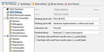

In STM32CubeIDE 1.13.1 i have the Floating Point set to Hardware implementation and it works.
2024-07-04 5:49 AM
Well it's complaining that the intermediate .S file it's generated has FPU instructions in the stream for some reason. Could be a tools or caching issue, or necessitating a "Rebuild All" scenario as the goal posts have moved, and it should rebuild the dependencies.
Could be a tool bug, or selective file level configuration (library) that's conflicting with the new choices.
You'll have to get into this with ST, they do that through the Online Support portal and ticketing system. https://ols.st.com/s/
2024-07-04 10:48 PM
I submit an Online Support Request.
Thank you.
