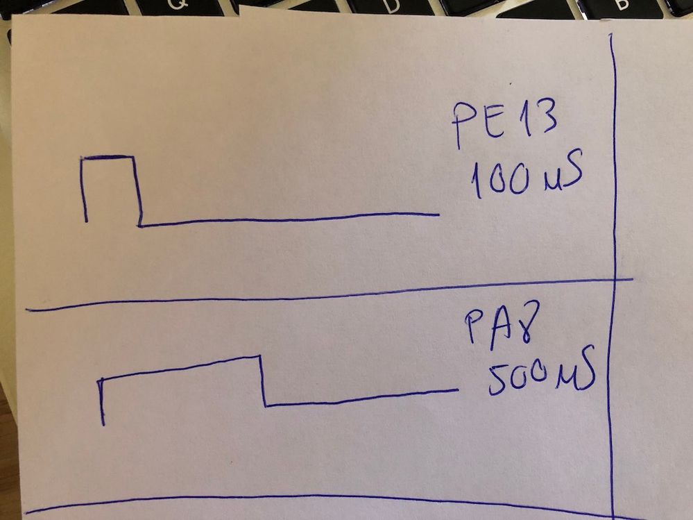

Try to post a screenshot from the oscilloscope and explain (perhaps make a drawing) of how it is different from the expectations.

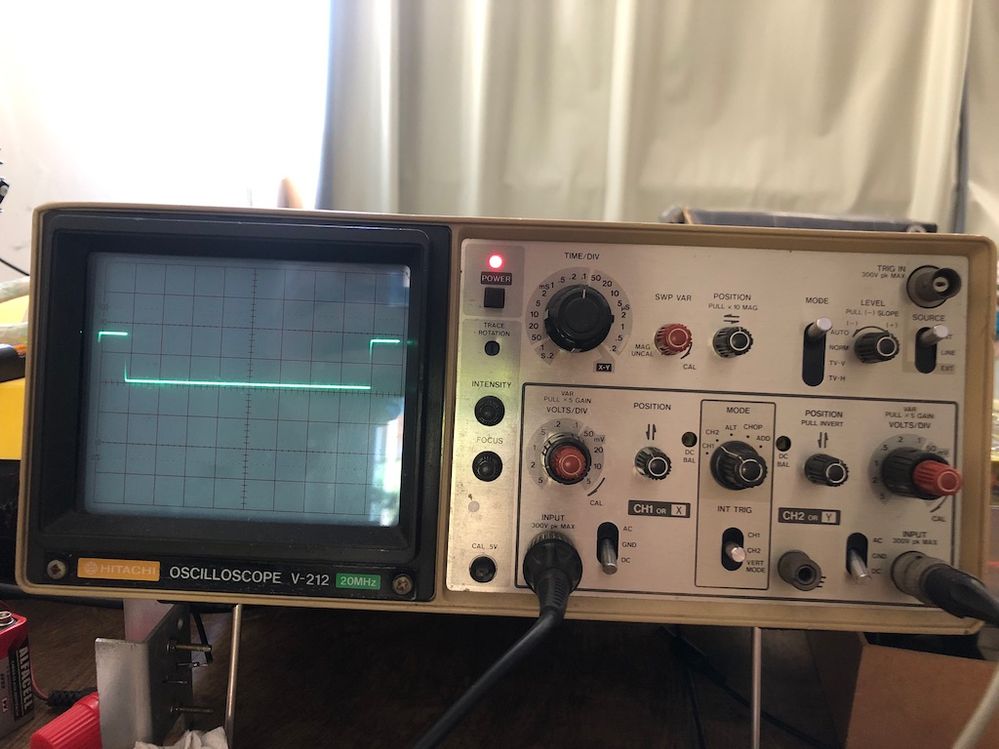

2025-03-29 7:34 AM
Below are the actual pulses and the drawing is what I expect:
PE13
PA8
Expected

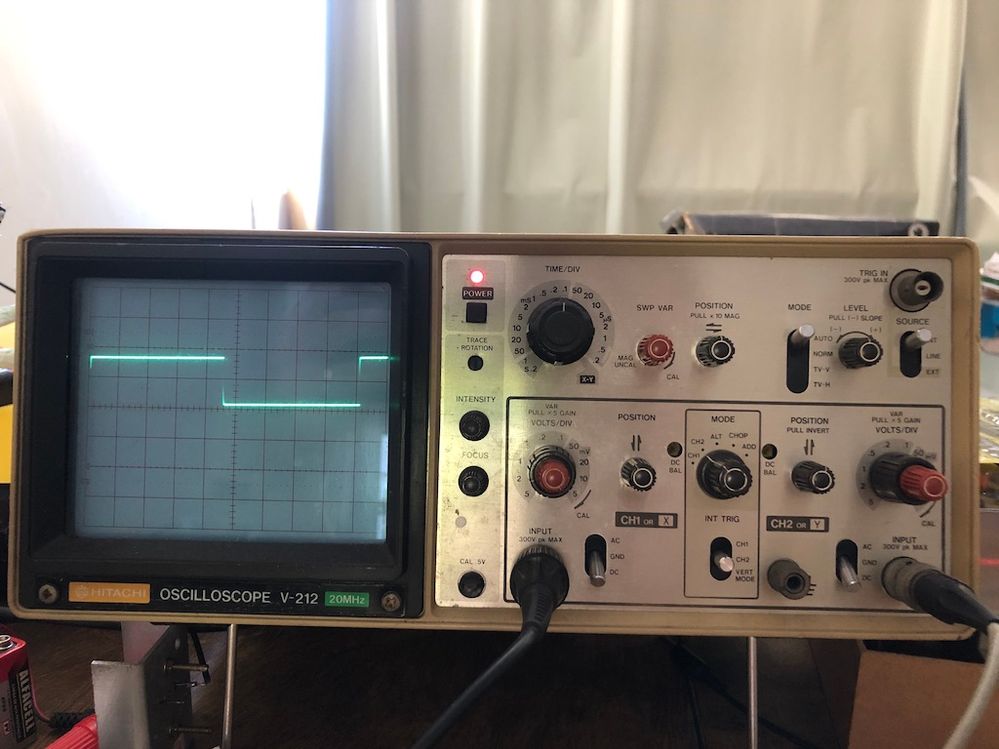

2025-03-30 1:09 AM
The scope screen shows one full period and the beginning of another period. I can't see anything wrong.
2025-03-30 5:17 AM - edited 2025-03-30 5:28 AM
As others have stated, it looks like you are getting a regular PWM sequence instead of a single pulse. Can you confirm that your pulses keep going? Or are their only two?
In general the way ChatGPT has setup this code is wrong. One should never assume an initial value of any register. Set the complete value yourself. As it is, there is no way to know exactly what is in register CR1.
// Force edge-aligned mode
TIM1->CR1 &= ~TIM_CR1_CMS; // Up-counting mode
TIM1->CR1 |= TIM_CR1_ARPE; // Auto-reload preload enableIn any event, you could try
TIM1->CR1 |= (TIM_CR1_ARPE | TIM_CR1_OPM); // Auto-reload preload enable, One Pulse Mode Enabled
2025-03-30 8:03 AM
Thanks, the pulses keep going, What I dont understand is why I see the 100uS pulse 2 times in the timeline ( of 1ms ) where in my understanding I should see it only one time in this time window. Or maybe I understand things wrong.

I think your understanding is correct. There should only be 1 pulse within the 1ms window based on the configuration I see. Obviously, something is not configured correctly, but its not jumping out at me. technically the duty cycle also gets a '-1' so
TIM1->CCR3 = 100-1;But I don't see that as a contributing factor. Where is your configuration for the 500us pulse?
Are you sure your scope plots match the code? I don't see any way to get other than a 1/10 duty cycle with the ARR and CCR2 set as they are. However, you are showing 1/9. Your registers don't match your scope plot. Be sure you are setting up the correct CCR register for the signal you are plotting.

I'm sorry, maybe the code I have send was some experiments and was not the most updated. Please look at the code below that is the one that generated the oscilloscope images:

2025-03-31 2:29 AM
You are seeing MORE THAN ONE PERIOD of your PWM on the oscilloscope screen.The pulse at the right side is the next period pulse.
