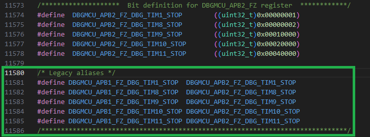

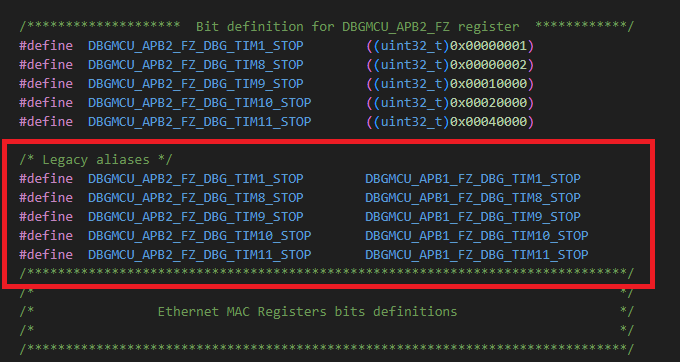

I found wrong code at
STM32F4xx_DSP_StdPeriph_Lib_V1.9.0\Libraries\CMSIS\Device\ST\STM32F4xx\Include\stm32f4xx.h file. Please see follow image:
This part code will cause incompatible redefinition of macro warning and maybe another issues. I think these codes in red rectangle should change as follow image:
