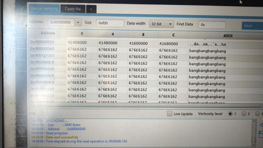

However I noticed that when writing data in the flash thanks to the function Flash_Write (will post it and every lower level function) at a memory address saved in a variable and then incrementing the variable from one for(;;) iteration to another then the data saving in the flash would not occur as it should. In fact while debugging the code and only doing 1 iteration of the for(;;) loop the data is written multiple times with the address incrementing, when it should only write it once, it's also very disturbing that the address increases before the line is executed

and here what only 1 ieteration of flash_write (while debugging) saves

How do you know only one iteration took place? Looks like you're debugging in STM32CubeProgrammer. Would be more useful to step through in STM32CubeIDE. Or write code that actually only executes a single loop. The code posted is consistent with the results you show.
2024-10-06 1:10 PM
I'm debugging step by step from stm32 cubde ide, I put a breakpoint at the for cycle, then take 3 steps over with the debugger, interrupt the debugging and open prg to see what's inside the flash. Isn't that 1 iteration?
2024-10-06 4:01 PM
The transition from debugging in STM32CubeIDE to connecting with STM32CubeProgrammer requires that the debugger be disconnected first, which lets the code free run.

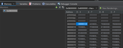

Use the Memory viewer in CubeIDE (Window -> Show View -> Memory) to do the same thing while debugging.
I would initialize the memory with 0x00 and verify at the start of the loop that the memory isn't already written with "bang", then execute one iteration and verify the results. If it writes more than once it's a logic error in Flash_Write that you should be able to track down.
