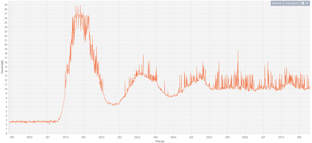

And my problem is when I measured the current consumption of this MCU, I found arround 3uA during only 3 minutes after starting the Stop mode and then arround 15uA until my system wake-up, as you can see on the next chart the Current consumption measure with X-NUCLEO-LPM01A at the
increase of current
:I already check the same result with an amperemeter.
It is like some internal power supply just turn on, but my system is always in stop mode.

I can't believe that such an oscillation (very nice capture!) may come from anywhere else than the external environment of the MCU.
Concerning the consumption, I bet that the MCU is somehow activated (from the outside) but is internally configured not to wake on that event. I/O configuration is likely to be the clue of this issue. How is it done ? Can you close all I/O and see how behaves the current ?

Well I cut each IO of the MCU and I have always the problem.
Also, I try the same test with an other board with the same components and I don't have the problem.
So perhaps I damaged my MCU by soldering or with static electricity.

Floating inputs can make current consumption to vary randomly. Does the current change if you move your hand close above the board. Floating inputs can do that too.
