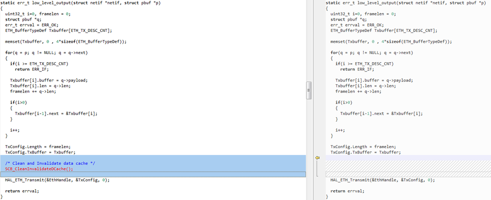

In ethernetif.c function low_level_output(), you MUST add the following code (bold font)
/* Clean and Invalidate data cache */
SCB_CleanInvalidateDCache(); HAL_ETH_Transmit(&EthHandle, &TxConfig, 0);then sample can run correctly in the board.
You can see the detail in the following picture.

Dear all:
I found
STM32Cube_FW_H7_V1.1.0 lwip sample(LwIP_HTTP_Server_Netconn_RTOS) can run correctly in the board. So after compare the different between this two project, I finally find
STM32Cube_FW_H7_V1.2.0 lwip sample code bug.
2018-07-04 8:21 AM
You are right. This problem is reproduced with STM32CubeH7 V1.2.0, and not with previous versions as the cleaning/invalidating the cache manner has changed starting from V1.2.0.
So, adding a call of SCB_CleanInvalidateDCache() in low_level_output() function (as done in version V1.1.0 nor V1.0.0) resolves the issue. This call is removed in Version 1.2.0.
Our development tool team is aware about this issue and should fix this limitation in the coming release.
Thank you for reporting us the issue and we apologize for any inconvenience this may have caused you.
