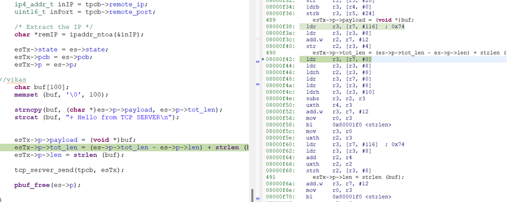

2023-04-25 6:10 AM - edited 2023-11-20 7:11 AM
2023-04-25 6:11 AM
Here is it, but question is same, How to identify the issue
2023-04-25 8:44 AM
That doesn't show the faulting instruction, or the MCU registers.
The MCU provides a lot of information about WHY it's faulting, you need to decode that, and review it in the context of your code.
Mostly likely here, as you aren't sanity check any of the variables or lengths, is that you're not receiving a NUL terminated string, and that what you are receiving is larger than the buffer you're placing it into.
If using the debugger, expect to go and inspect the content of related variables and buffers.
I've posted multiple times what I think a minimal Hard Fault Handler should look like and report.
