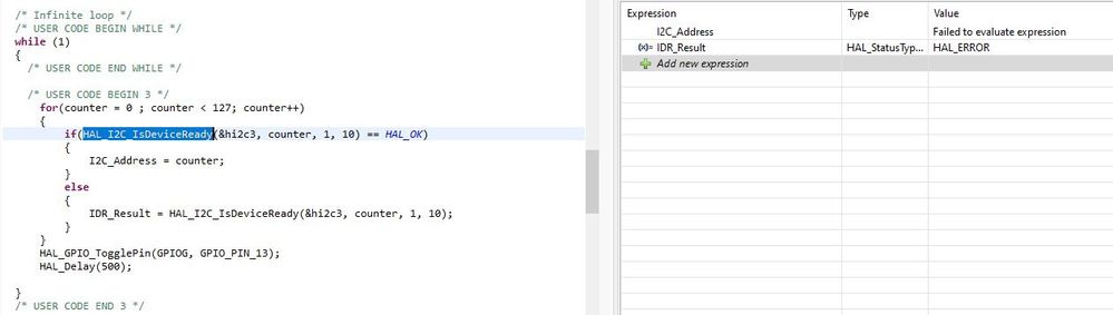

Let me correct my self, I got HAL_OK at counter 0 and 1, not in 2.
Also I change my code to more clear debugging, but still doesn't get anything.
while (1)
/* USER CODE END WHILE */
/* USER CODE BEGIN 3 */
for(counter = 0 ; counter < 255; counter++)
IDR_Result = HAL_I2C_IsDeviceReady(&hi2c3, counter, 3, 10);
if(IDR_Result == HAL_OK)
I2C_Address = counter;
HAL_GPIO_TogglePin(GPIOG, GPIO_PIN_14);
HAL_GPIO_TogglePin(GPIOG, GPIO_PIN_13);
HAL_Delay(500);
/* USER CODE END 3 */
2021-07-27 7:04 AM
