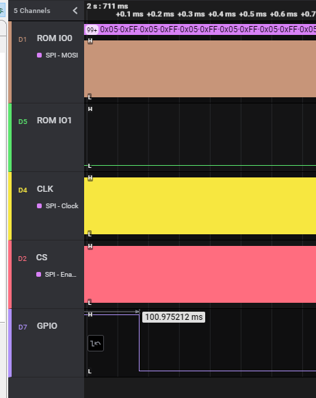

I am sure than the timeout is working properly since my external pin is toggling as expected (after 100ms) as you can see in the screenshot of my logic analyser.
0693W00000Ly1ApQAJ.pngBut you can also see than the communication is not stopping even with the presence of the HAL_QSPI_Abort command.

The timeout seems to be working. The pinout toggles as expected. Did you check the QSPI registers set by the HAL? It's surprising HAL_QSPI_Abort does not reset the autopolling flag in the QSPI registers.

The timeout seems to be working fine as indicate by the GPIO on the logic analyzer.

Yes the timeout is working, I played with different time value and the GPIO pin is evolving as expected.
