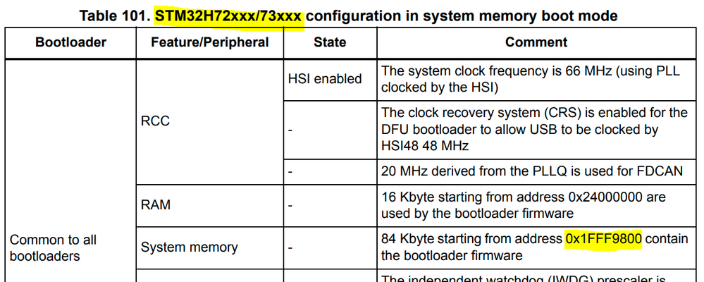

2021-05-22 5:01 AM
From the screenshot above:
> The system clock frequency is 66 MHz (using PLL clocked by the HSI)
This seems absurd. As the HSI has frequency of 64 MHz. While technically it can be done, I don't see a point of using a PLL to rise the system frequency to 66 MHz, which is almost the same. And it's not the case on other H7 sub-series either.
@Imen DAHMEN , @Amel NASRI , this should be checked and/or corrected.
