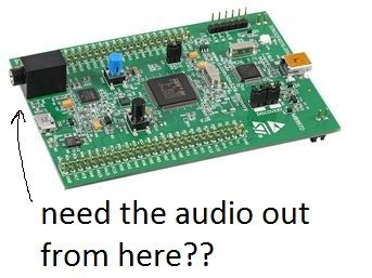

the board is stm32f407vg:

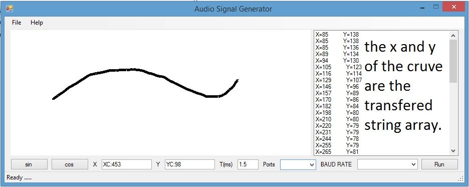

my application transmit an string array to the serial port:

This is the CS43L22 output, not related the internal DAC of the MCU.
The Discovery firmware package, which waclawek.jan linked to in his post, contains example code for this chip.
