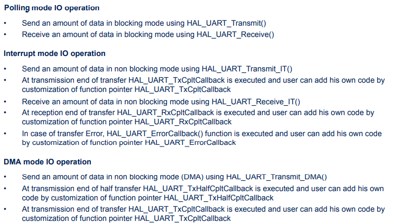

For each STM32Cube firmware package, you should find a user manual explaining the HAL & LL drivers of each STM32 product. If we take as example STM32F4, you will find UM1725 Description of STM32F4 HAL and low-layer drivers.
So here an extract from this document explaining the 3 operating modes for UART:
-Amel
2022-05-25 7:19 AM
Thanks for directing me to the right docs, I took the harder path of digging in the HAL source code ;) This document clarifies it well enough.
