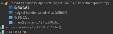

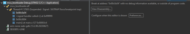

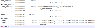

Right now that semaphore location is set to 0 so it attempts to boot from the GOLD_ADDR location (0x080C0000).
If I program the application itself (after changing the STM32H735VGHX_FLASH.ld file to have flash start at 0x080C0000) and changing the VECT_TAB_OFFSET in system_stm32h7xx.c to 0x000C0000U it works perfectly fine. I can verify that we're in 0x080C0000+ space with the PC when debugging directly and can verify that the VECT_TAB_OFFSET is being set correctly because when I set it back to 0, interrupts no longer function correctly (and at 0xC0000 they do work correctly).
If I attempt to boot with that bootloader code above though, I end up hitting the application's hard fault handler (shown below):
I can verify in the .map file that the applications hardfault handler is at 0x080c0a54. Looking at the stack trace it seems to imply the hardfault triggers upon the calling the instruction at 0x80C0004. This is confusing to me though because it seems like the hardfault happens sometime after jumping but before reaching my applications main function. I think that because after line 62 in the above bootloader main function is called, the stack pointer is set to 0x24050000 but when the hardfault occurs, its equal to 0x2404ffe0 (the same value it seems to be when first reaching the main function). If I put an infinite loop at the start of my applications main function though, I still end up in the hardfault when using the bootloader instead of stuck in that loop.
On the other hand though, looking at 0x80C0004, it contains 0x80C0D3D which seems like the address to the reset handler (0x80C0D3C) but not word aligned. Is it possible that this is where the issue is coming from? If so, why does that value get generated when compiling and programming the application project and why does it work when directly running but not when using the bootloader? Looking at the bootloader's equiavlent address (0x8000004) it's 0x8000691 it's also the reset handler + 1.
Is there something else I'm missing?
It's NOT an INSTRUCTION, it's a pointer in a Vector Table
Correct, and it's ODD because it's 16-bit THUMB(2) code, even addresses infer 32-bit ARM code, which the CMx MCU's don't run.

I did try to follow along with the debugger but stepping into the application pointer just immediately hardfaults too. I'm not sure if that's just because I have the STM32 IDE inproperly setup or if it's truly failing on the initial jump itself. What I just noticed though is that it seems to hardfault with a different instruction address 0x80c02cc (which seems to be empty space between the isr_vector and the .text section) than if I just run it. Not sure what to make of that at all.
The CFSR lists a different reason for hard faulting in that case. Instead of an EPSR issue, it's an undefined instruction fault. (CFSR of 0x10000). That makes perfect sense as 0x80c02cc is unwritten (it contains 0xFFFFFFFF).
I will definitely make a note of that for the clocks/PLLS and remove those from the application.
I'm not sure why doing the step into and just running would have different results like this.

Dump all the vectors in the 0x080C0000..0x080C02CB vector table as uint32_t
It would appear you've transitioned from the SCB->VTOR at 0x08000000 too 0x080C0000 at this point.
