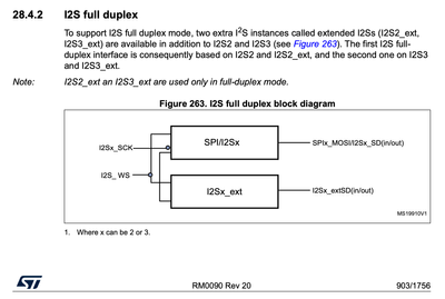

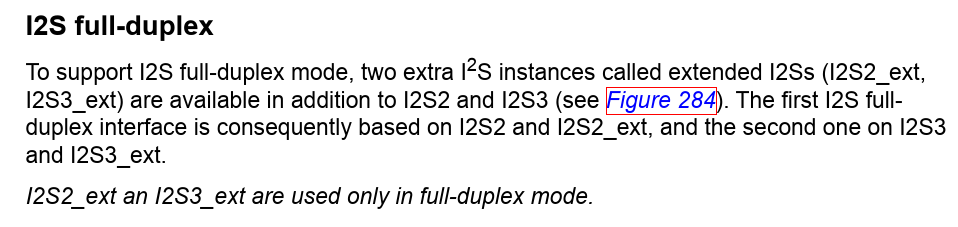

2024-04-30 9:46 AM - edited 2024-04-30 1:33 PM
Thanks for the really helpful advice everyone, that is totally clear. I was searching the PDF and didn’t find that diagram, will be less lazy next time :) because it is not in the data sheet. Instead it is in the Reference Manual RM0090 and appears to be slightly different.
