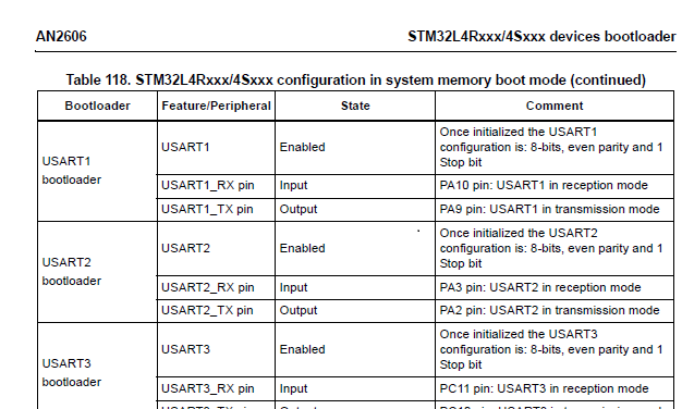

AN2606 lists all peripheral units that are always re-initialized (e.g. UART, SPI, I2C, ..)
What happens to the other ports and GPIOs (e.g. Port E/F/G)? Are all GPIOs reset or do they keep their last status?

It only enables clocks and peripherals it is using, if it uses PC11 I suspect it enables the clocks and blind writes into registers it assumes are at reset defaults.

1) fyi it is PC15 on an stm32f405 in my particular case, which should be unused for usb, CAN, and the rest of the stuff in AN2606.
