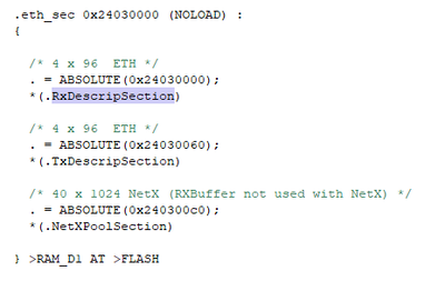

First thing I note that you have problem of my post
RxDescripSection in eth.c is not RxDecripSection in xxxflash.ld - an s is missing and that appears in v1.12.

Hello @mbarg.1 ,
thank you so much - you made my day! This got me up and running.
"RxDescripSection in eth.c is not RxDecripSection in xxxflash.ld - an s is missing and that appears in v1.12"

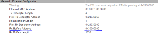

Hi @OskarP
I thought RxBuffer was not used in NetXDuo... this is what I have in my .id file:
seems to work for me on an H743
Matthew
