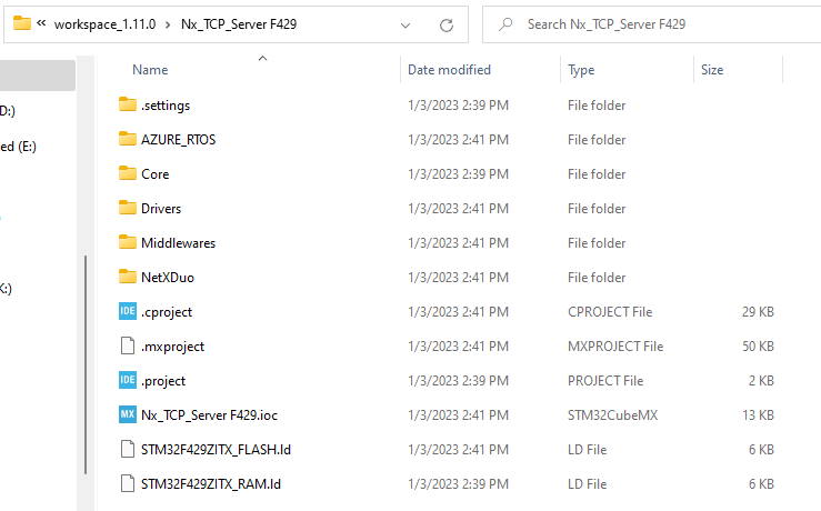

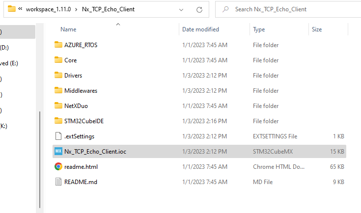

2023-01-03 11:54 AM
This appears to be a problem with the project structure generated by CubeIDE rather than with VCOM.
The projects that were not communicating with VCOM were actually not running correctly. The code generated by CubeIDE was incomplete (I think). Therefore the only thing that was running was the MCU and its basic functions. The actual Azure code was not running.
I WAS able to get one project to run, and it DID communicate with VCOM port. Here is the example file structure of the working project.
But below is a typical file structure (generated by CubeIDE). This project does NOT work, nor does it communicate with the VCOM port.
Notice that the working file structure has a STM32CubeIDE folder, but the non-working project does not.
Can someone point out what I am doing wrong?

2023-01-03 4:06 PM
It's hard to tell what is wrong in the generated project without debugging. But [more often than not] cube-generated projects do not work as is, need some manual adjustment.
So it is recommended to always start from a ready example rather than generate from scratch.
