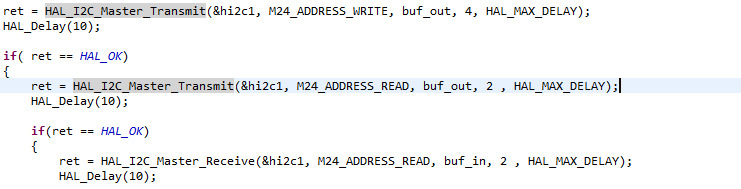

I made an I2C communication between STM32U585 uC to an I2C EEPROM and it works
I do the following
but if I remove the HAL_Delay(10) or minimizes it to less than 10msec things are not working well, the second call I2C_Master_Transmit fails.
Is there's a way to call the I2C_ISR register or anything else, in order to check if the writing process was completed before proceeding with the communication?
Thanks!

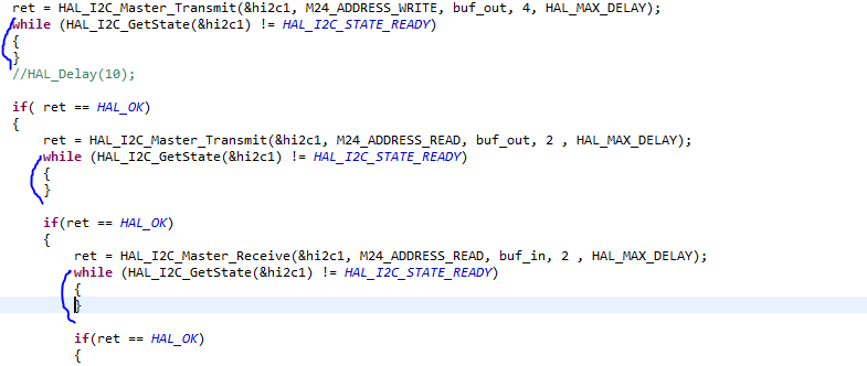

2023-03-14 8:23 AM
Thank you so much! I tried it, as shown below
And it didn't work for me. Only after bringing back the HAL_Delay(10) the program worked properly, without it, again the second call to HAL_I2C_Master_Transmit fails.
Am I using it in the wrong way?

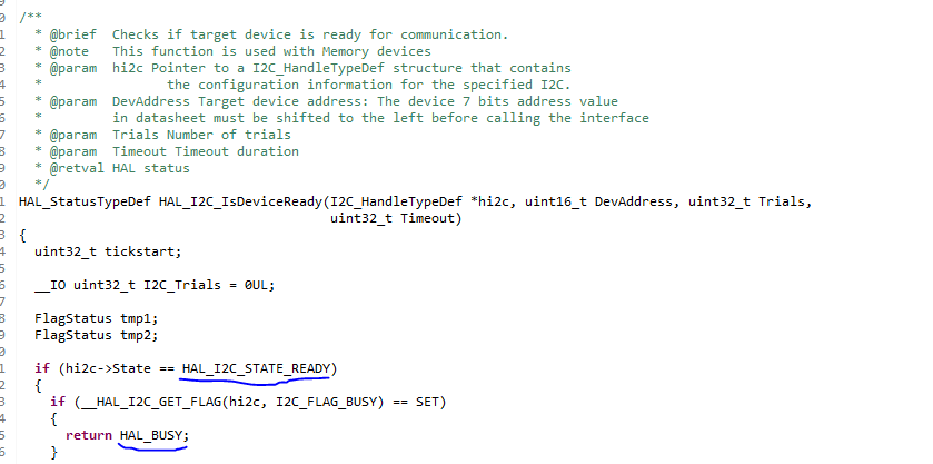

Hi, thanks for the reply. "second call fails" means that it returns HAL_ERROR.
I switched according to your advise to the HAL_I2C_Mem_Read/Write() functions and called HAL_I2C_IsDeviceReady with a while empty loop. I found that it is the right choice here, since the state HAL_I2C_STATE_READY which is the one I would wait for by calling HAL_I2C_GetState() does not necessarily mean that the device is not busy, as can be understood from the HAL I2C code below:
So the code which is working as I would expect is:
ret = HAL_I2C_Mem_Write(&hi2c1, M24_ADDRESS_WRITE, MemAddress, MemAddressSize, buf_out, DataSize, HAL_MAX_DELAY);
while(HAL_I2C_IsDeviceReady(&hi2c1, M24_ADDRESS_WRITE, 1, HAL_MAX_DELAY) != HAL_OK)
if( ret == HAL_OK)
ret = HAL_I2C_Mem_Read(&hi2c1, M24_ADDRESS_READ, MemAddress, MemAddressSize, buf_in, DataSize, HAL_MAX_DELAY);
if( ret == HAL_OK)
{Thanks a lot!
